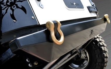

Hey all, just got my poison Spyder BFH rear bumper...called the company for instructions and they said alot of guys would just remove the rear crossmember and weld in a 2x3 box as an option. Who has this bumper and what did you do to install it. I really like the bumper and already commited to the cuts for the template...no going back now. Any help appreciated!

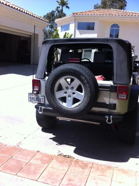

My brother is running this bumper. We got a little frustrated with the cutting, we just removed that middle piece altogether.

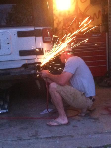

Put on a long sleeve shirt, gloves, and some safety glasses and go to town. I did mine in shorts and flip flops...lol. I cut a few inches off my exhaust

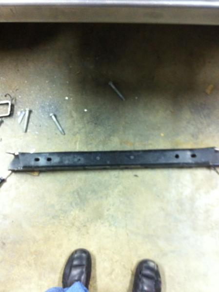

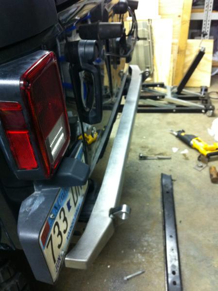

If you guys removed the rear cross member completely, What is supporting your rear body mounts?
Old Jan 19, 2012 | 08:25 AM
snopro269's Avatar
Posts: 1,240
From: rochester,mn
Minus one rear cross member
