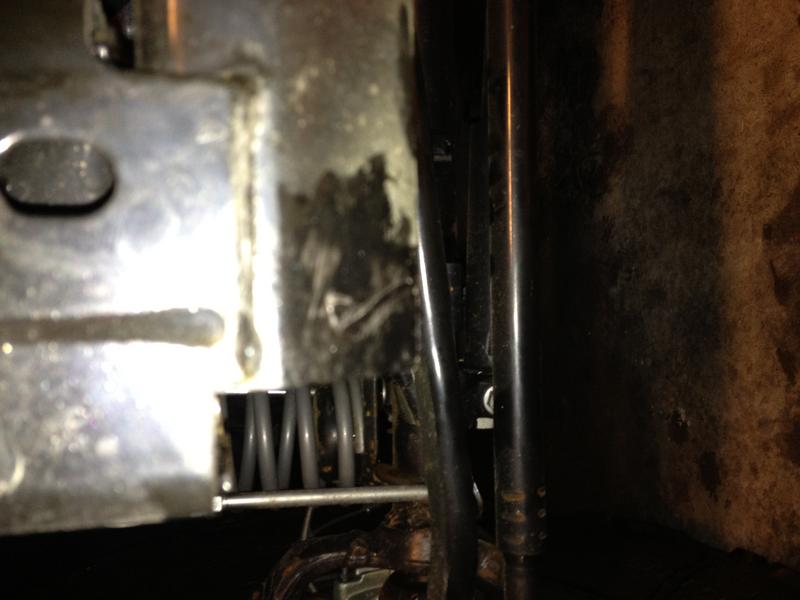

Got the ski mounted to the bumper, fogs installed, and trimmed the crash bar as described in the instructions. It's going onto a 2012 JKU with 6,000 miles. The bumper slides onto the frame rails, and everything APPEARS to line-up almost perfectly, but no amount of pushing, whacking, or hammering will make it budge. I tried slightly enlarging the holes on the frame rails with no success..
Running out of ideas here, any suggestions?

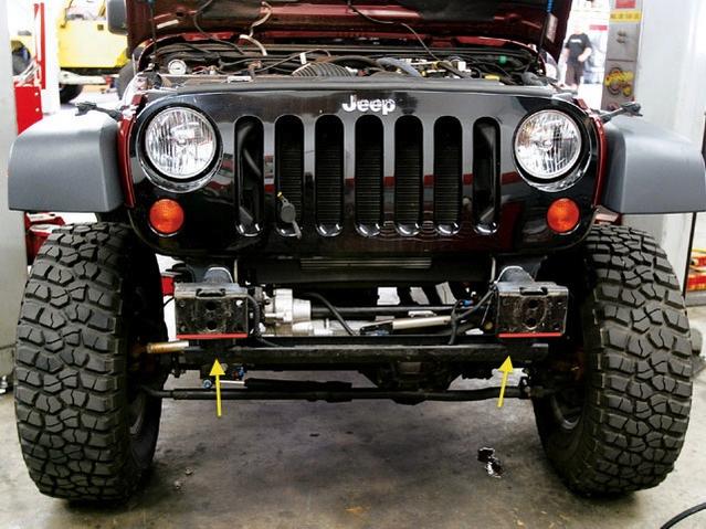

FINALLY got it on. Had to grind back the lower end of the frame-rail end, as crudely shown in my edited photo:
I had to take about 1/8th of an inch off of both side, and increase the size of the holes a bit. Hopefully this will help someone in the future.
Attachment 410293
How it sits now:
looks good. welcome to the club
