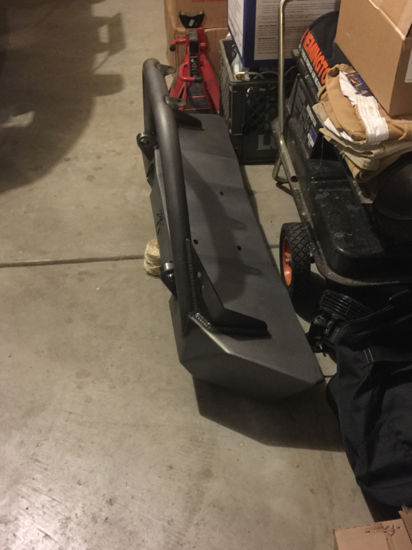

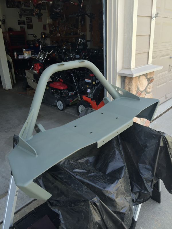

um you might want to call them. I just saw a new coating that they provide now on selected parts. Worth checking out..I installed a brawler light front bumper few months back and painted it myself , came out nice Click image for larger version

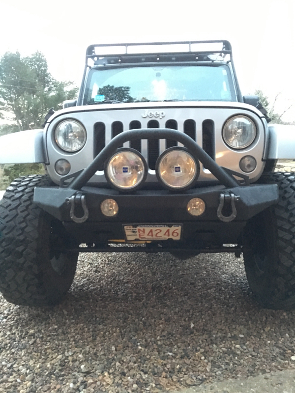

I epoxy primed mine then had them Line-Xed. Highly recommend this. They're bulletproof now

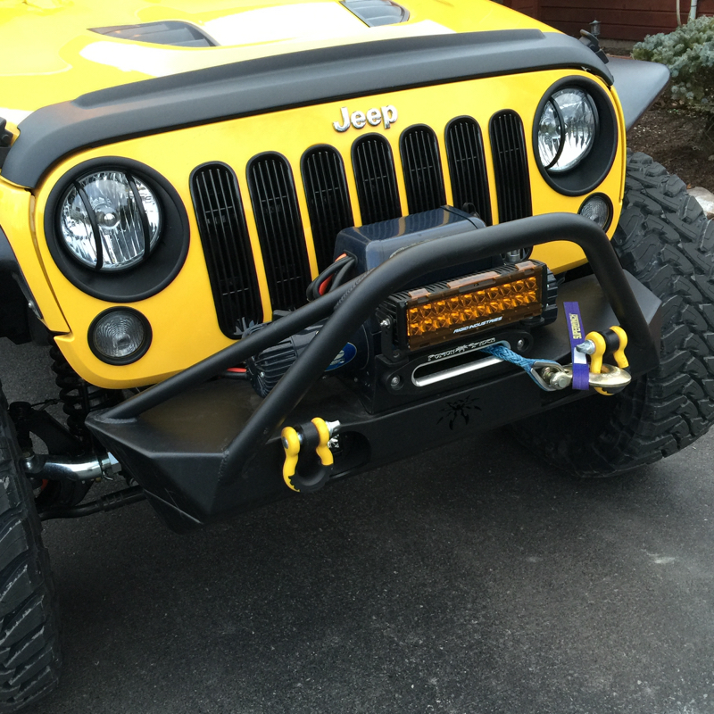

I took mine to powder coat shop. They zinc coated them first and then the black powder coat. I think they look great.

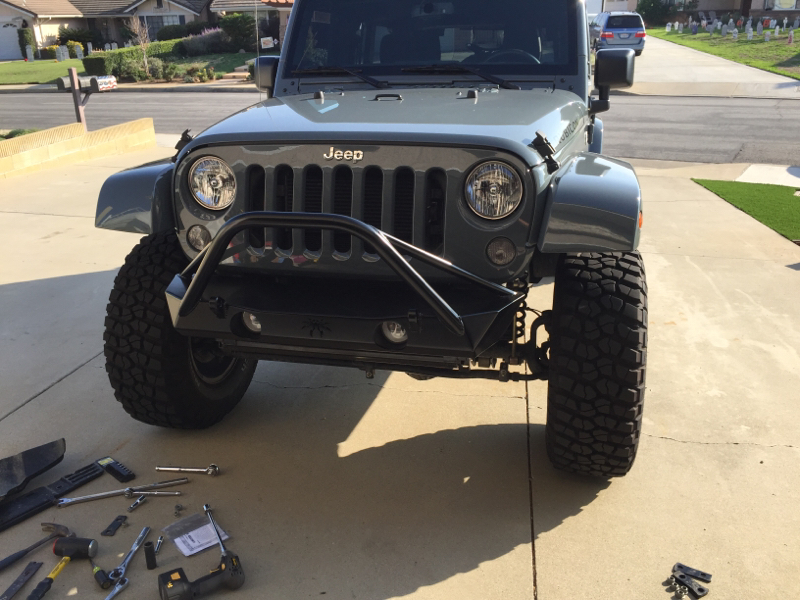

Painted mine using satin black rust-o-leum, came out great and easy to touch up when scratched. I also sanded/ground off all sharp edges around laser cut edges. Turned out nice!!
