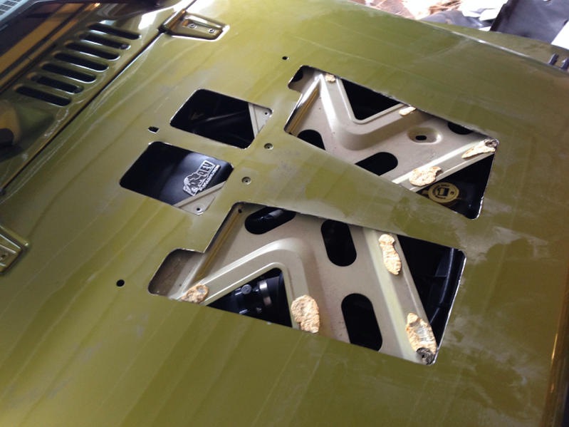

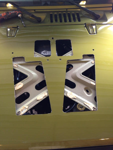

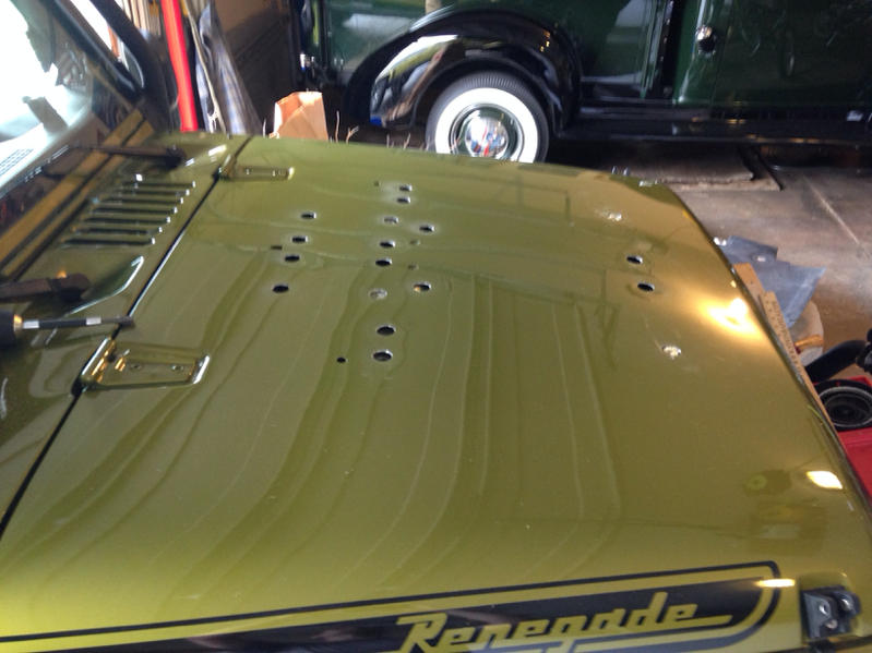

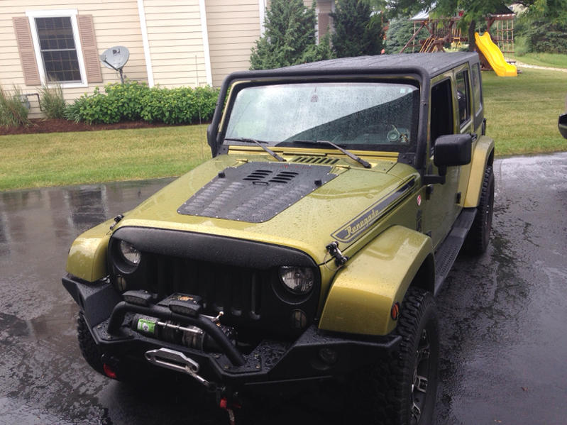

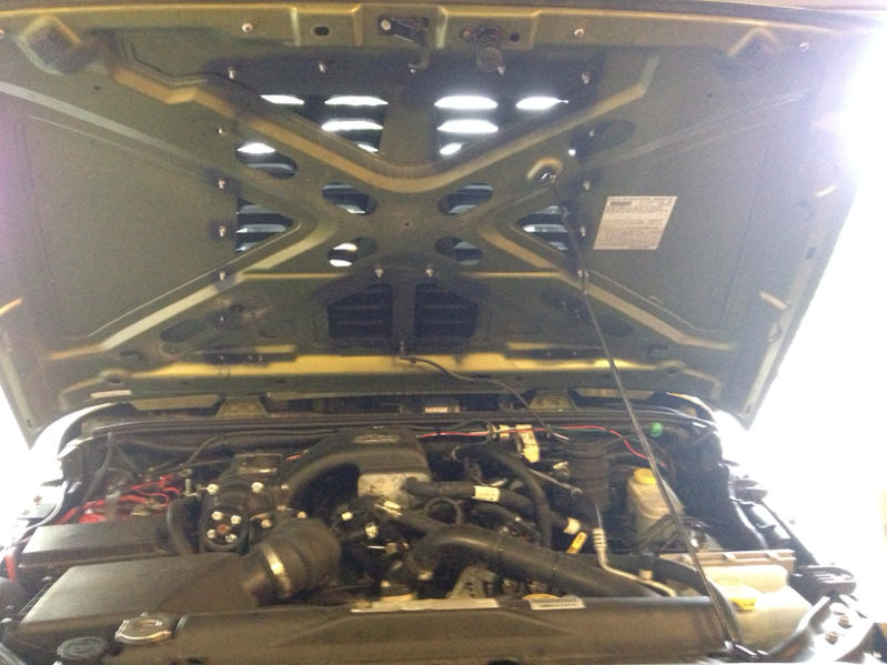

I debated purchasing one of the many heat reduction hoods on the market now. I attended the Easter Jeep Safari in Moab and made sure I looked at all of them that are on the market (yes- there was so many jeeps I did end up seeing every one I wanted too - plus a few more). After seeing all of them in person, I felt the Poison Spyder was by far the best (and most economical) option. I just could not see spending the premium for a full hood when these look so cool. I figured if I trashed my hood during the install, I would replace it but the install was fairly easy.
I left it on. I know the risks and had a fire extinguisher handy just in case. I put plastic down when I painted the edges. No issues. I'm tall enough that it was not an issue with reach either. Just took my time and it all worked out fine.
