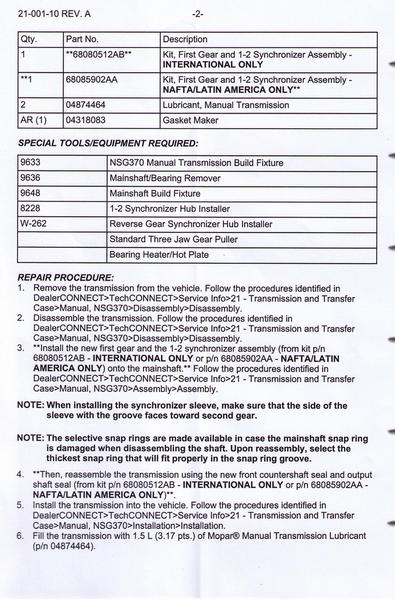

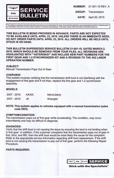

Ya I just found this thread. For the issue. I'm going to take the shifter boot off ad see if that's the issue not allowing me to go all the way into 1st. Thanks guys
