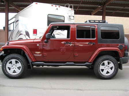

Installed 2" FT BB lift with mono-tube shocks on Sun.
Got the steering wheel centered - easy to do.
New shocks no doubt firmer than stock.
Lift looks nice and will fit my 33's just great when they arrive.
Might need front end alignment check - here is why. Going over small bumps (have not hit any big ones yet) at freeway speed makes the jeep feel a little "squirly" kind of like a small side to side movement. Not major, but was not there stock. At slower speeds, I am feeling "something" in the steering wheel, very minor but being detail oriented it is not exactly the same feel as stock. I am still running the stock 32" tires, 18" Sahara rims, and stock steering stabilizer. What else could I check that might be causing this? It's minor but just noticable. Normal? I doubt it.

Did you install the FT Trackbar Relocation Bracket? If so, then remove it.

Yes I did install the included Track Bar bracket. Also am using JKS quicker disconnects up front which are extended length for the 2" lift - the sway bar sits nice and horizontal.
So, remove the Track Bar bracket? Hmmmm. This will shift the axle to an "abnormal" state since the lift moved it a little. How could this be good? If I recall the Track Bar without the bracket only uses the one bolt right? Has anyone else had to remove the bracket? It is interesting that the Terra BB does not seem to include a relo bracket and their lift is 2.5" yet the FT lift comes with the bracket and I spoke to Steve at FT at some length about it and aligning the bolt holes. I went through a lot of pain to get the darn thing installed - not sure why???

Woods...I found earlier posts explaining the issue with the FT track bar. So I went out to the JK and measured the axle shift using the board against the wheel method. To make a long story short I pulled the FT bracket and amazingly the shift is barely noticable going back to the stock mounting location and more noticable with the bracket. So much for the FT bracket and pain I went though to get it installed correctly. A quick road test appears promising! Thanks very much!!!
