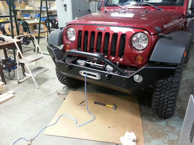

Powdercoat definitely.
Sandblasted, Zinc'd, and Powdercoated a used bumper I bought. Looks brand new. Is rust inhibited thanks to the Zinc coating. Ended up costing me 165 bucks. (65 to remove the paint, rust, and previous powder-coating, and 100 for the powder coat and zinc)
Totally worth it IMO. Despite what anyone says, it's the most durable coating you're going to put on that metal.

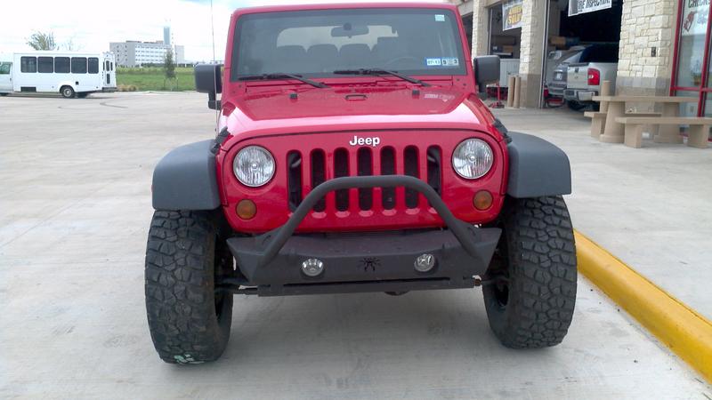

I primed with self etching primer and sprayed with Duplicolor bed liner.
