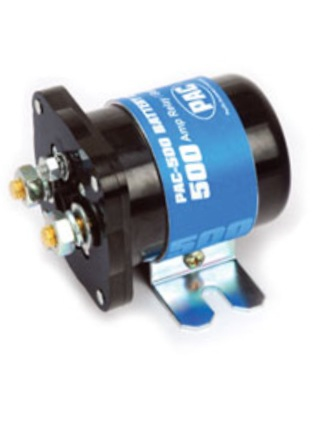

Use. This and wire the big poles in line with the winch power. One small pole to ground and the other to accessory. This way the winch is powered up when the key is on and off when the key is off. Or you can wire it to a switch with one pole little pole to battery + and the other little pole through the switch to ground.
