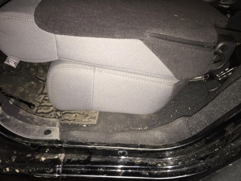

Can the rear seat(s) still be folded down when an inverter is underneath them?
The back of the seats fold forward. The space underneath stays the same.
No. On the JKU the lower portion of the seat pivots to the floor when the seat back is folded forward.
