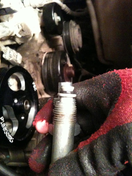

So I am installing my new PSC high volume power steering pump and all is going well. Then I was ready to install the pressure line and found that the fitting in the pump is a male fitting and the fitting on the pressure line is also a male fitting. Suggestions on where I might find a fitting to connect the two?

Old Feb 10, 2013 | 05:01 PM
computerprosllc's Avatar
Joined: Mar 2009
Posts: 31
From: Baltimore, Maryland
I am in the process of installing same thing. My line looks the same, and just screwed into my pump. It looks like you need to unscrew the fitting from the pump. I could take picture of mine tomorrow. Is that the PSC pump?
Old Feb 10, 2013 | 05:03 PM
Joined: Mar 2009
Posts: 31
See the threeds in your pressure Ile, and the rubber o ring seal at the end. That screws right into the pump. Stock or PSC.
Old Feb 10, 2013 | 05:13 PM
hneiper's Avatar
Posts: 518
From: Katy, TX
That is the one thing I didn't try. You might have saved the day.

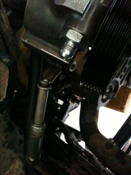

Old Feb 10, 2013 | 05:32 PM
hneiper's Avatar
Posts: 518
From: Katy, TX
Originally Posted by computerprosllc
I have the same one. You just need to take out the AN fitting and screw the line in.
I just tried that. The AN fitting is larger diameter than the pressure line end.

Old Feb 10, 2013 | 05:41 PM
hneiper's Avatar
Posts: 518
From: Katy, TX
Here are a couple of picks comparing the pressure line end and the fitting from the PSC pump. One top view and one with pressure line in front of the fitting from pump.

Old Feb 10, 2013 | 05:42 PM
Joined: Mar 2009
Posts: 31
Mine screwed right out of my stock pump, and back into PSC pump. I will take a picture tomorrow. It might be the wrong pump. Your only other option would be to make a an6 hose up and connect it to the steering gear.

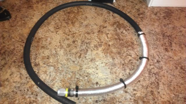

Old Feb 10, 2013 | 05:46 PM
Joined: Mar 2009
Posts: 31
Here is a picture of my return hose I made up to go from my cooler to my reservoir. You could make something like this with a an6 female fitting on one end and a an6 male end on the other end to go into the pump. It is 3/8 inch tubing

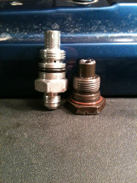

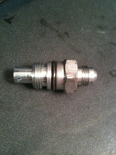

Old Feb 10, 2013 | 05:50 PM
hneiper's Avatar
Posts: 518
From: Katy, TX
Pics with better lighting
The first two are like before comparing the pressure line fitting to the fitting into the pump. The last shows the fittings from the new(left) and old (right).
I tried using old fitting but its diameter is too large to fit in new pump. And tried pressure line directly and that diameter is too small.
