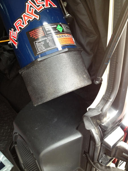

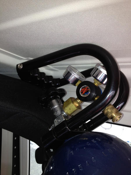

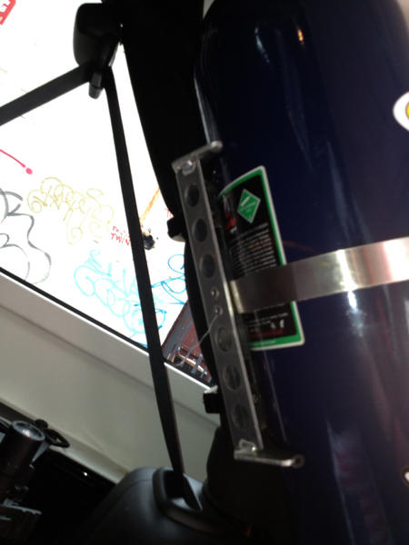

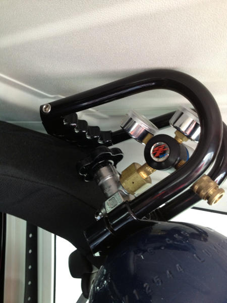

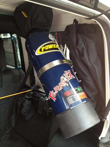

I have a JKU and went with the 20# tank with the powertank mounting bracket and rollbar clamps. I mounted it to the passenger side rollbar and it is rock solid. As you can see in the pics it has about 1/8 of an inch clearance ate the top ( with the nylon handle cover on) and about 1/4 inch from the factory sub and the hardtop glass. It sits at about 55 degrees so I don't even pull it out when filling tires. Occasionally I will take it out to another rig on a trail to help air up or use air tools, and of course to refill. It cost me 25$ to refill it at a fire extinguisher shop. I personally love the 20# tank. In the JKU it doesn't take up much useable room and lasts quite awhile even when running air tools. It is maybe a tad bulky when hauling outside the jeep but I have never had a problem where I wish it was smaller.
