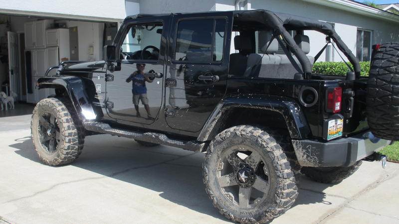

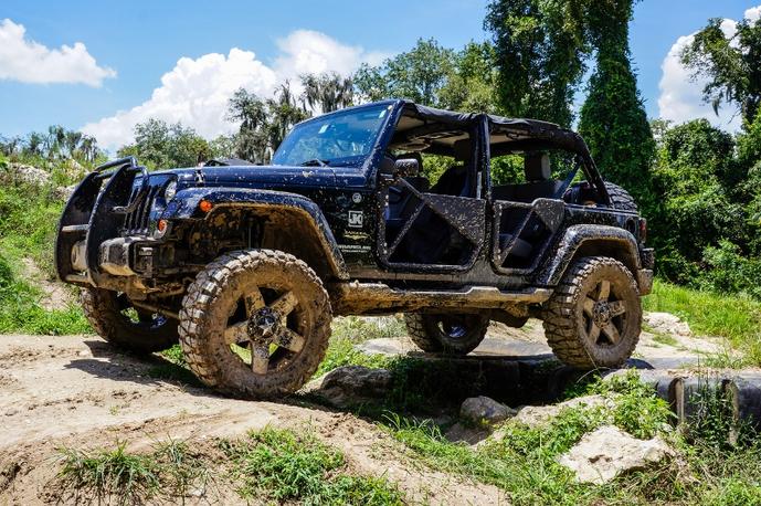

You may need spacers to avoid some rubbing at full turns. Also get rid of that plastic air dam in the front of your vehicle as it will just be in the way. Your current set up (lift and wheel combo) will handle the tire size fine. If you do venture off road you will rub the fenders if you are disconnected (sway bar) with this set up. I run a 3" lift and I rub now when I tuck the wheels from hard articulation. The spare will go on your carrier but it may not clear without a spare tire extension as it may hit the bumper like mine did. I would also recommend MBRP reinforcement brackects to help distribute the additional weight on the tail gate until you get a carrier. Other than that you should be good otherwise. Enjoy!
Similar set up ...
