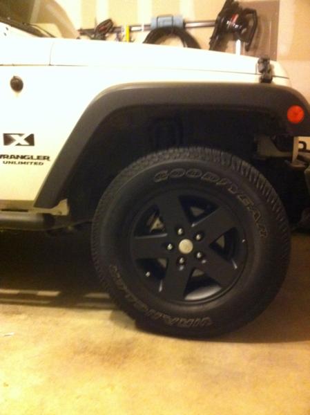

Turned out great. No primer, 3 coats of bedliner. Love it!!
