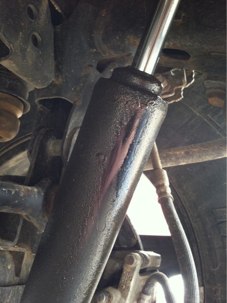

Here's a set of 15 thousand mile shocks from the procomp kit .... I learned the hard way save your money and buy good parts once instead of buying junk then buying good parts afterwards
I see that now lol live and learn

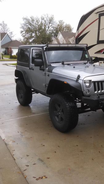

This is the after pic lifted
