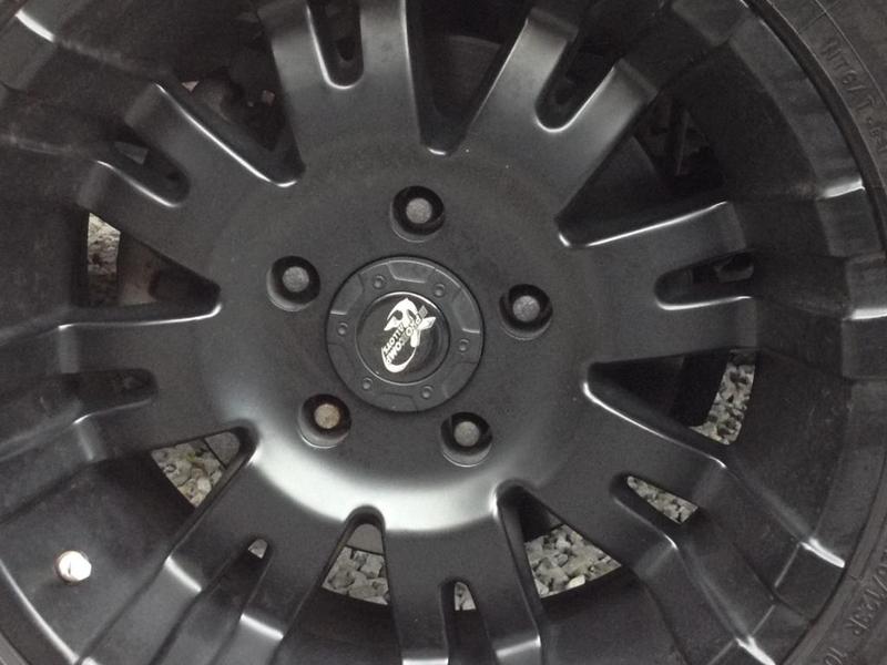

Another dumb question. This is a 5 on 5 bolt pattern?

I saw other options for wheels (ie, 6 X 6.5" which I'm assuming is a 6 lug and 6.5" across). Just want to be sure to get the specs right when I sell.

The JK bolt pattern is 5x5. Tj was 5x4.5 and you will find 5x5.5 in a 5 lug wheel.

Hey thanks. Appreciate you sticking with the noob.
