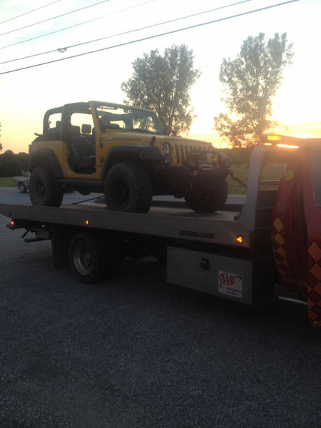

Thanks everyone. Well... My transfer case let go yesterday evening so the dual stabilizer is on hold for a little bit. I think that little plastic retainer clip in the linkage broke but I haven't gotten in to look at it yet. We'll see... But thanks again everyone. I'm still up for more advice and experiences.
