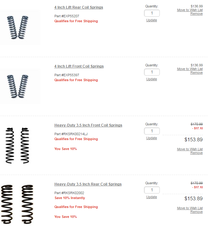

I would also say this......once you read up and really understand everything that should be addressed in a lift, there is nothing wrong with piecing things together. For example Pro Comp shocks really suck. I had em, I know. If you decide you want Pro Comp springs, buy those separately, pair them with Blistein or Fox shocks. Here is what you'll start noticing......4 Pro Comp springs cost might cost $275 for a set of front and rear springs, whereas Rock Krawler springs might cost you $306. Take a look of this snapshot from 4WP website -
I'm just using 3.5" springs here as a numerical example. If you don't think the RK springs are worth an extra $31 over the life of your jeep, you'd be cra cra. My point here is just once you understand all the components you need to address, you can really compare things on an apples to apples basis vs. just looking at lift packages. When you look at packages you see the big final price, then you have to start digging and determining what each package includes or doesn't include, and factor those costs.
