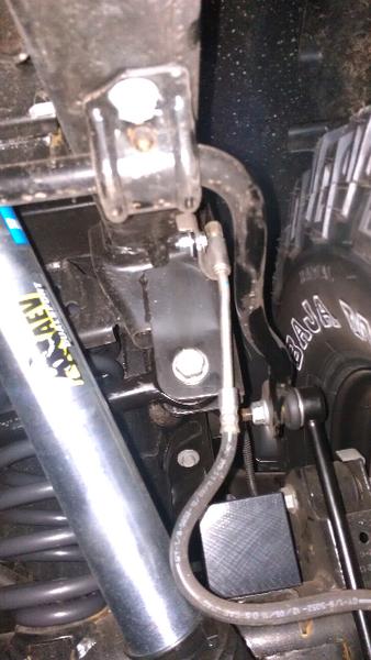

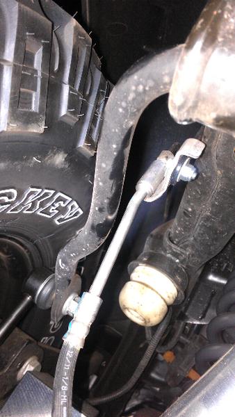

The first 2 pics are driver side rear that shows that the swaybar willcontact the brake line and the 3rd is passenger side rear where it will contact.

Posted up some pics. Its the actual sway bar that comes into contact with the metal brake lines on partial flex. I don't understand how it could be but it does. The drop brackets are installed and seem like it could be the culprit. I may need to bend the drop brackets to have the brake lines avoid the swaybar.
