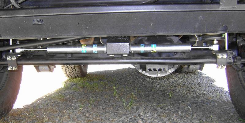

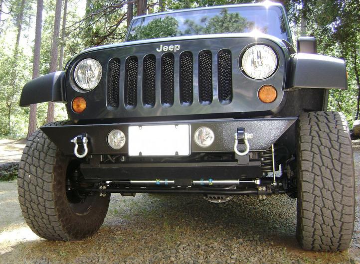

Originally Posted by OH9JK
There are many complaints about that Bilstein causing pull to left. This is due to gas charged like a shock...it wants to fully extend because under pressure.
Honestly the factory steering stabilizer with a relocate kit is as good as anything.
Yeah unfortunately, the Bilsteins are known to pull to one side. Unless you run dual bilsteins, this set works awesome for me!Click image for larger version
ID:	341292Click image for larger version

Originally Posted by k0260
Yeah unfortunately, the Bilsteins are known to pull to one side. Unless you run dual bilsteins, this set works awesome for me!Attachment 341292Attachment 341293
Does the dual setup work with a flip drag link?
Old Jul 15, 2012 | 12:00 PM
RacerXS's Avatar
Joined: Sep 2009
Posts: 97
From: Matawan, NJ
Originally Posted by nkijkuit
Why would this fix pulling to the left?
It will not fix the pulling to the left, that will only be fixed if you get rid of the Bilstein stabilizer, or go with the double unit shown above.
