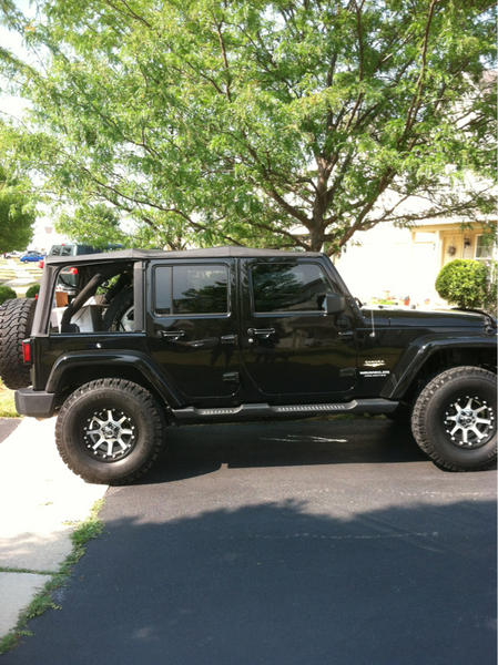

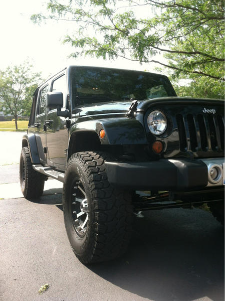

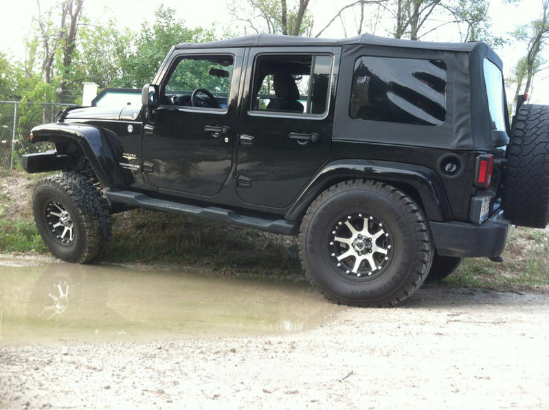

I recently put a teraflex 2.5 lift, 35 x 11.50 baja ATZ, jks track bar, brake drop brackets and jks discos on my jeep. It runs great currently.
I am wondering how these mods increase wear on other components. For example ball joints, and power steering. Seems like the power steering pump wines more with the 35 and wondering how well the oem pumps are holding up? Also with the wider stance, how well do ball joints and other components last? I love the mods but hesitant to take her on the trail because I'm worried about added strain from the mods.
What problems have u guys had after lift and 35s?
Thanks
