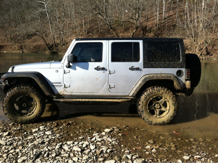

I've got the pro comp lift also.... Dealer installed. I knew nothing about suspension setup prior to coming here. I regret buying it lifted but still love the look, I'm slowly building up parts to correct some of it's issues. Modifying it is half the fun of jeep ownership. As far as flightiness it's not to bad with my km2s it does have bump steer issues and rides like a goat but so far no death wobble. Still I love my jeep and am looking forward to tinkering with it!!
