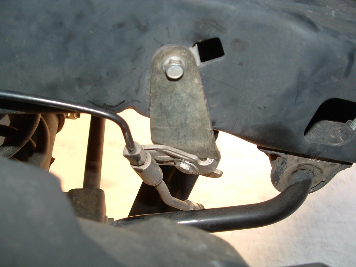

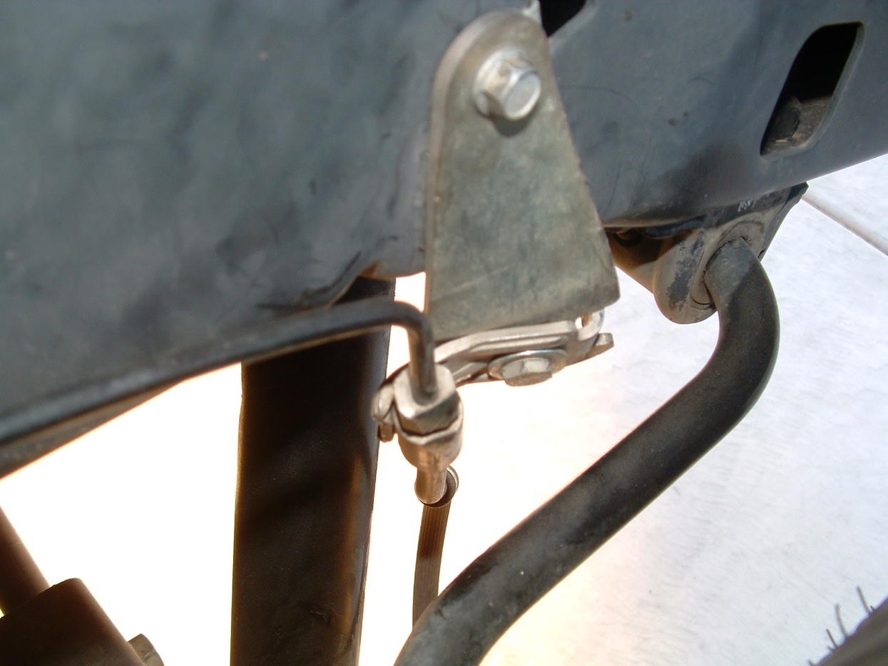

Not all teraflex users are satisfied at first i really liked my 3" full mid arm lift until i found out that the rear track bar relocation bracket slams into your rear shock the fix you have to buy a shock relocation bracket and a new shock then had my tires rotated found out that the brake line relocation bracket puts the brake line right in the way of the rear antisway bar as your rear axle flexes the antisway bar hits and rubs on your brake line very dangerous worn almost all the way through contacted customer support their fix "no return phone calls" this lift was installed buy the jeep dealer when i bought the jeep new. there is a serious design flaw in this lift kit.
