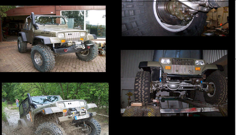

Pros and cons of using Axeltech Bolt-It. When operating JK.
I am a newbie and forum and I find it hard to understand the issue raised by me are not interested? Or topic was actively discussed earlier in the forum? Or modification of your car using Axeltech Bolt-It excludes the car in the competition (and therefore not interesting)?
Vendors claim that Axeltech Bolt-It car gets a fantastic performance.
("Bolt On Portals" portals to the existing axes are grown. They are so designed that the rotation of the axes is maintained. This is achieved through the use of 4 gears in the portal.
Another advantage of the 4 gears is that the load is distributed over the flanks of several gears.
This allows a higher power is transferred and the temperature evolution is much lower.
A translation of our bolt-on-web "of 1.6 to 1 is equivalent to an approximately 60% reduction of the load comes on the axes. It could be a 60% gain equal share of the axis.
The Achsgesamtübersetzung changes course by a factor of 1.6. This makes it possible to drive large wheels without addition the translation of the differentials to approximate.
The portals give the vehicle a "lift " of about 5 inches (12.5 cm). To drive larger wheels on all gear needs no further changes possible. The entire axle and steering geometry remains. This is also the only Bodylift actually brings a real ground clearance with it. The extra ground clearance under the differential is 12.5 cm.
To be driven to achieve this clearance with normal wheels, the axles would need 25 cm larger than the one you go with portal axles.
That would mean 25 cm larger wheels for most axes to certain death does not mention maneigentlich, not to mention the costly changes that are necessary to mount such large wheels.)
What problems await?
What details need to be changed in the car?
I have many questions.
I would like to get answers.
Best wishes ....
