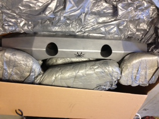

What type of spray paint would give it the best appearance? Any photos of those who sprayed their bumper? Still debating what should be done for such
Old Mar 3, 2013 | 09:16 PM
Jkforlife's Avatar
Joined: Oct 2012
Posts: 182
From: Pismo Beach, California
This is the bumper btw

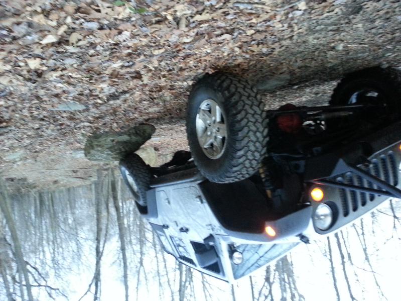

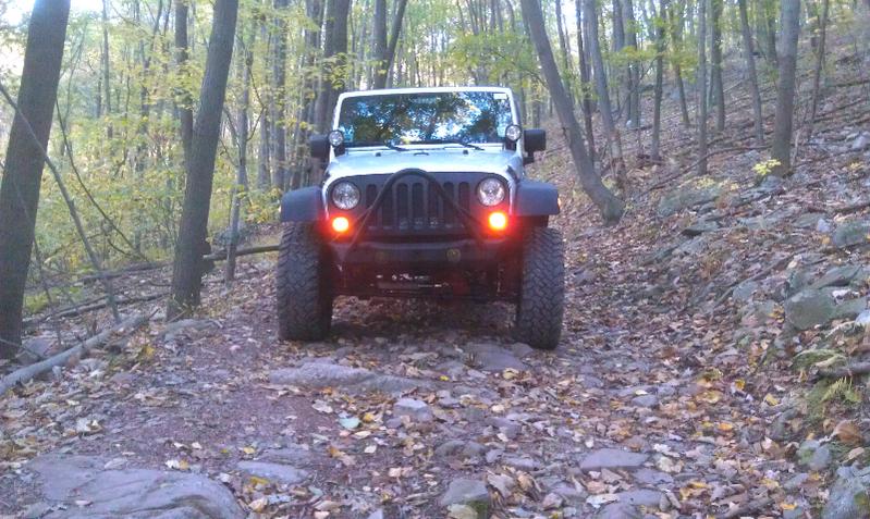

I painted my brawler with self etching primer, and then a few coats of bedliner. Turned out great!
Make sure u use a scotch Brite pad and scuff up the raw metal before using the primer. I used 1 can primer and I think 6 cans bedliner.
The app flipped the pic.

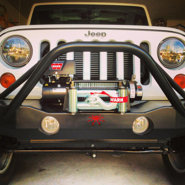

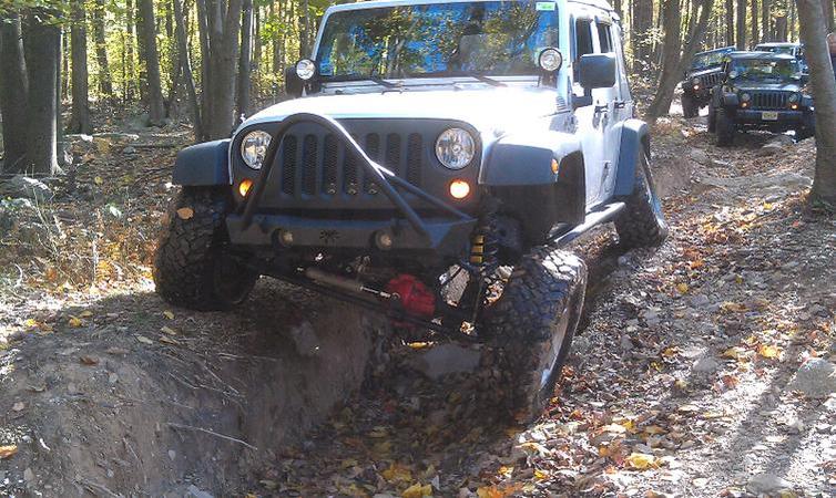

Better pics for u.
ID:	429532   Click image for larger version

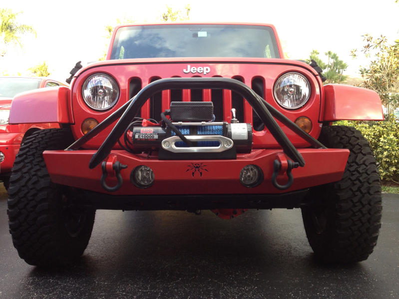

Here's the finished product!
Old Apr 2, 2013 | 03:08 PM
Jkforlife's Avatar
Joined: Oct 2012
Posts: 182
Here it is
Old Apr 2, 2013 | 03:15 PM
CajunTiger's Avatar
Posts: 673
From: Houma, La
Originally Posted by Jkforlife
Here it is
What model Warn winch is that?
