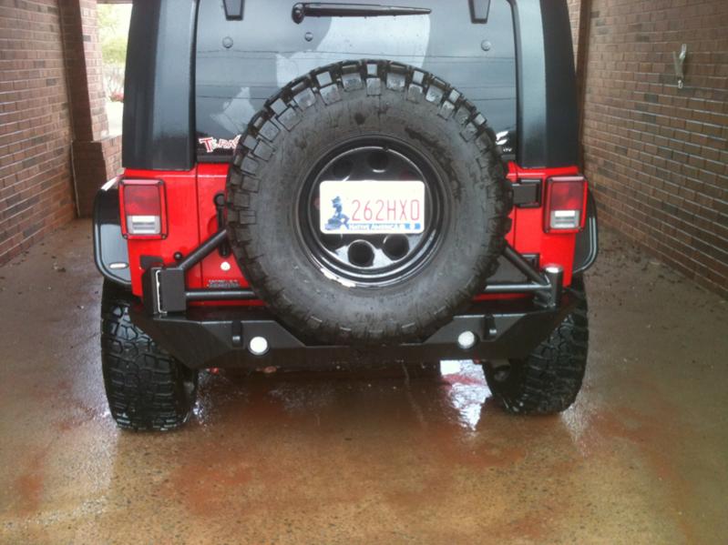

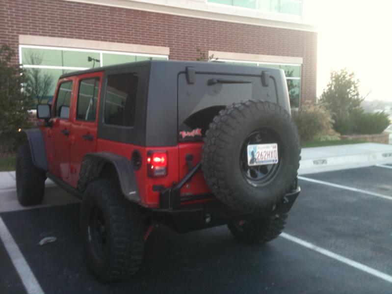

Here you go brawler front and rear.

Brawler front and rear here! Great looking/working bumpers!!! Though I do have to say I love the looks of the BFH's! (I just wasn't ready to cut my Jeep so, Brawlers for me!) Can't go wrong w/PSC!
