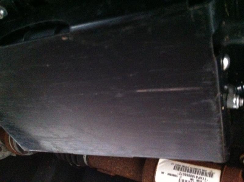

Mine got good scratches and a dent on it the first time I went wheeling, glad I had it on or the evap woulda taken a beating, I'll see if I can post a pic...
