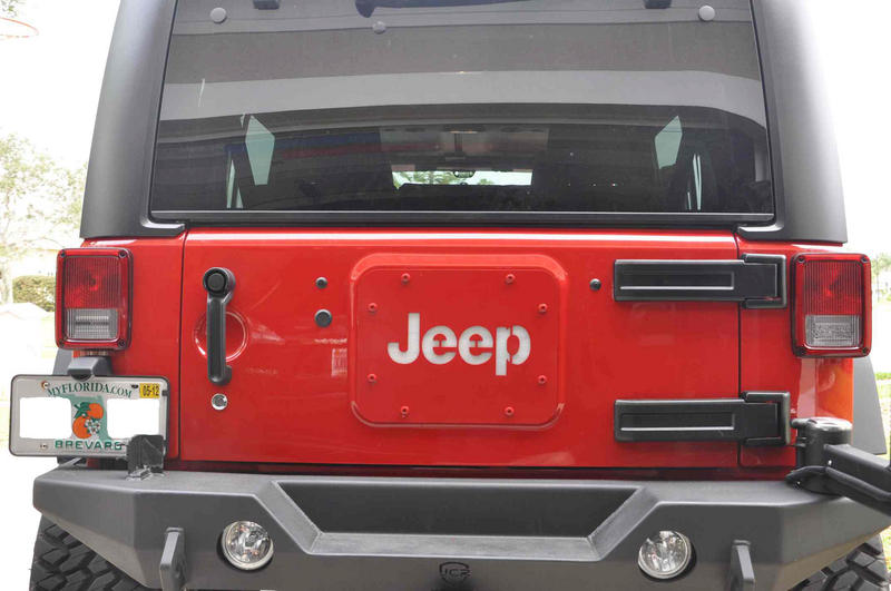

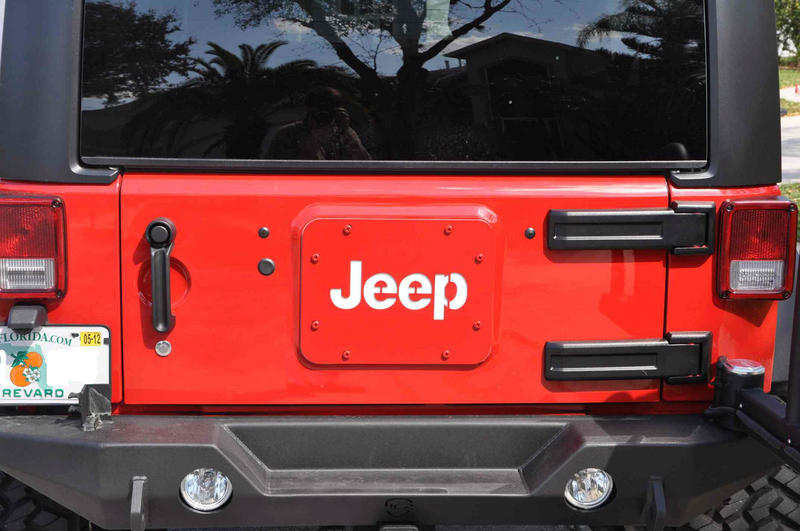

I removed my cabin air vent after I installed a JCR bumper and tire carrier and installed a Desert Snake Offroad Tramp Stamp custom cut in a "retro-Jeep" theme. At first I blocked the airflow figuring a JK was leaky enough not to notice (hardtop installed)...wrongo. The buffeting effect on the ears with the AC was bad, so Plan B. I replaced the solid blockage with two layers of aluminum bug screen spray painted white and the airflow was fine.
I now have the soft top on and I probably wouldn't notice a difference either way. I never thought the airflow would matter, but it indeed does.
Here's two pics of my tailgate Tramp stamp. the first one is with a lucite solid blockage behind the steel Tramp Stamp, the second is with the screen. The screen is hardly noticeable.

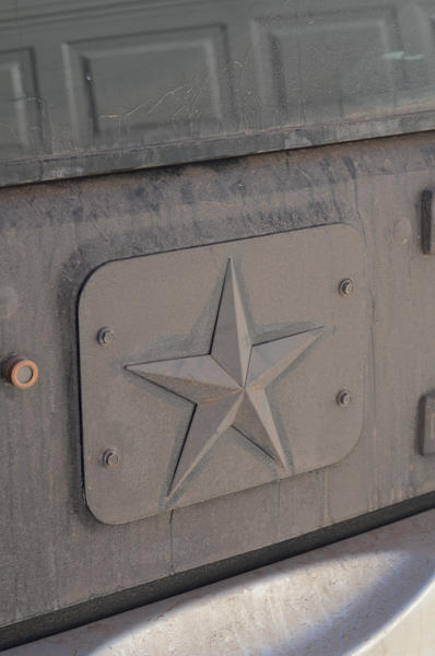

I have a RR Tailgate ST cover... Didn't like the vents in it so I sealed them up with bondo.. Then it looked too plain so I added a star. I spaced out the cover with 1mm nylon washers between the cover and gate, no probs with hard top on since.
