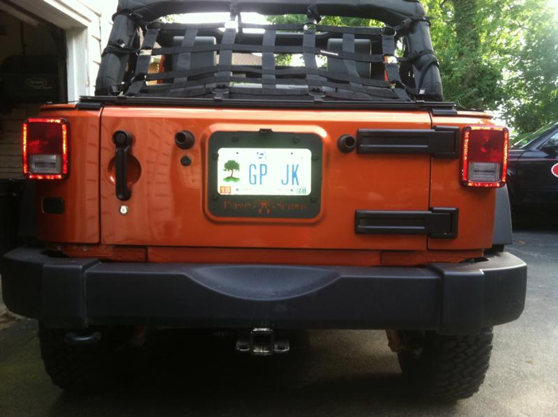

Old Aug 25, 2011 | 06:57 PM
BadPunkin's Avatar
Posts: 1,575
From: NE, Ohio
I did the same thing with drilling and reusing the stick carrier hardware. License plate fits fine.
