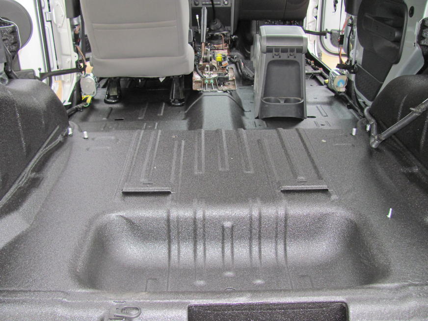

can't get Line-x in a can.....it is sprayed at 120 psi and is applied Hot! Rustoleum or Tremclad will cover your problem spot for now.....no primer or clear needed.

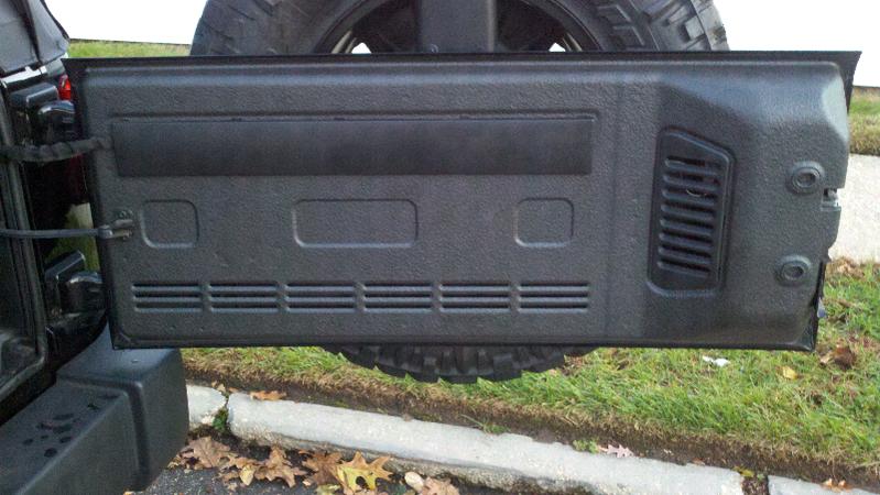

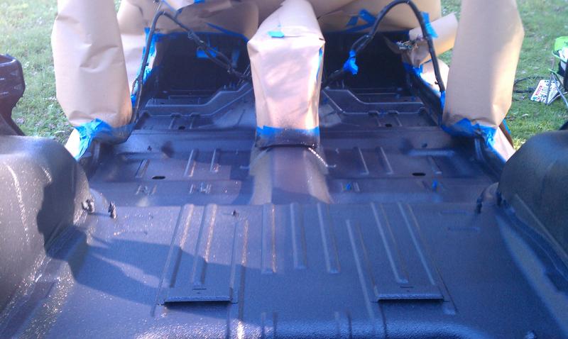

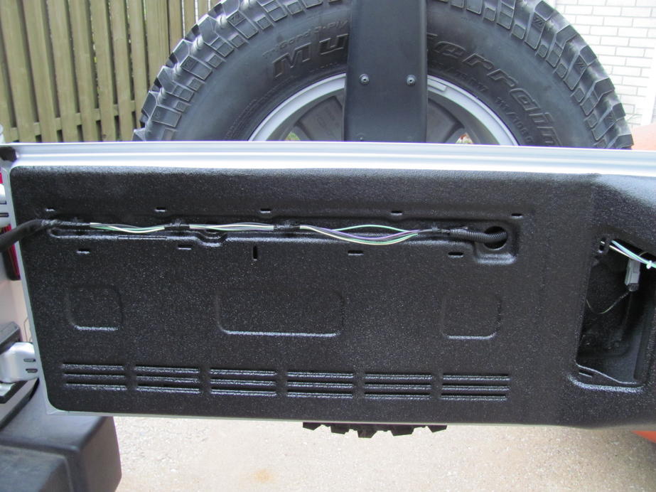

here are some pics of the Line-x to get you motivated! This is the best money i ahve spent on my Jeep so far. No more stinky carpet and i never worry about getting stuck in the rain without the top on. Easy to clean as well...just fill the footwells with soap and water, scrub with brush , pull drain plugs and rinse.

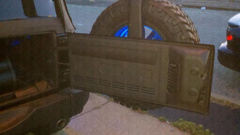

I rhinoed interior. Best $ I ever spent on jeep!!

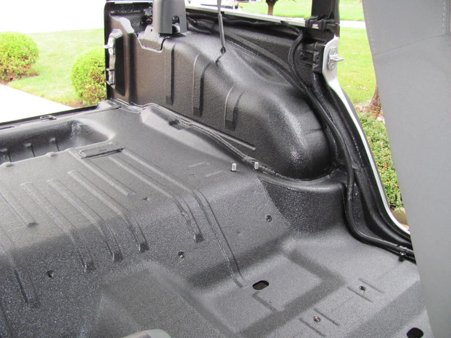

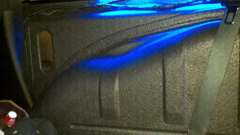

Yes it does! Did my tub with Raptor Tintable kit. Purchased a 30 gallon compressor and bought the kit for LESS than what it would cost me to have someone Line-X it. Re-routed my wires though the roll bar...shit looks good for real!
