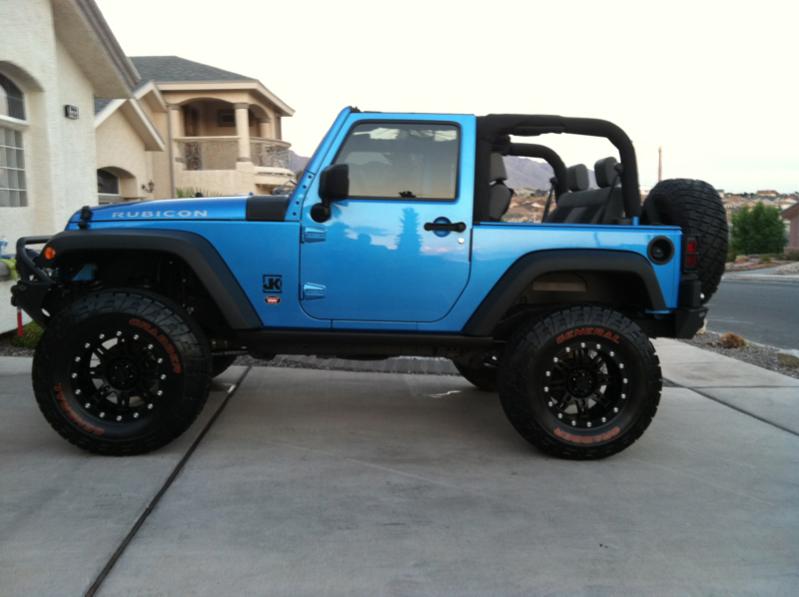

I have that exact set up on mine!
I did replaced the front driveshaft, mine went bad due to the lift that flexes so frigging much when you disconnect the sway bars the rear will be ok though because the RK lift moves the rear differential back helping the angle of it.
Here is mine with the 3.5 and bilsteins w/35's

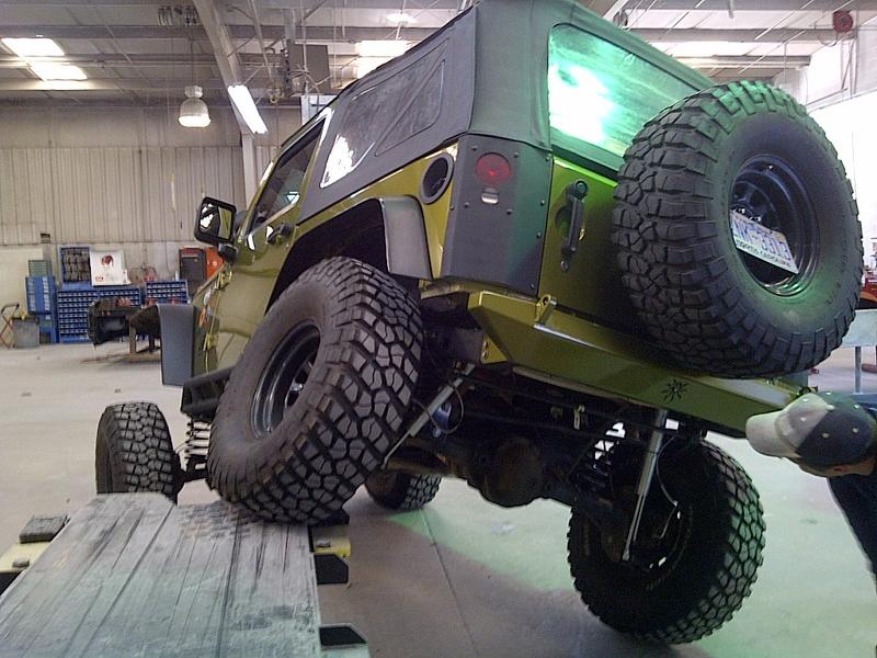

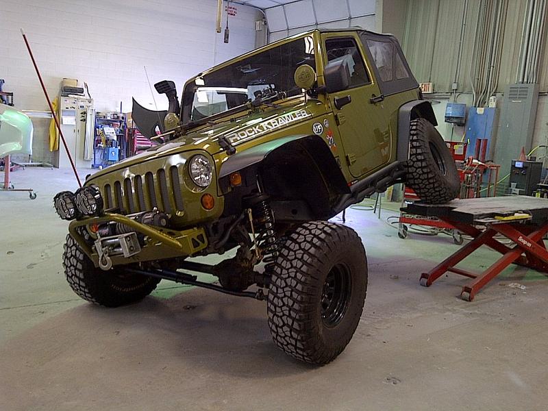

Same setup I've got, and yeah the flex for the money can't be beat. Here's when I tested it, would have went higher but the abs lines were getting pretty tight. BTW, with my brother we put on the lift in a day, and that was taking our time, I say do it yourself if you can.
