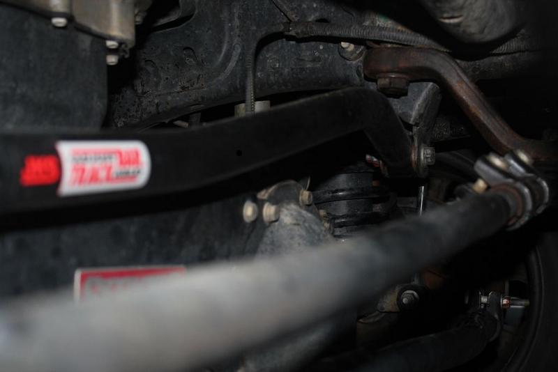

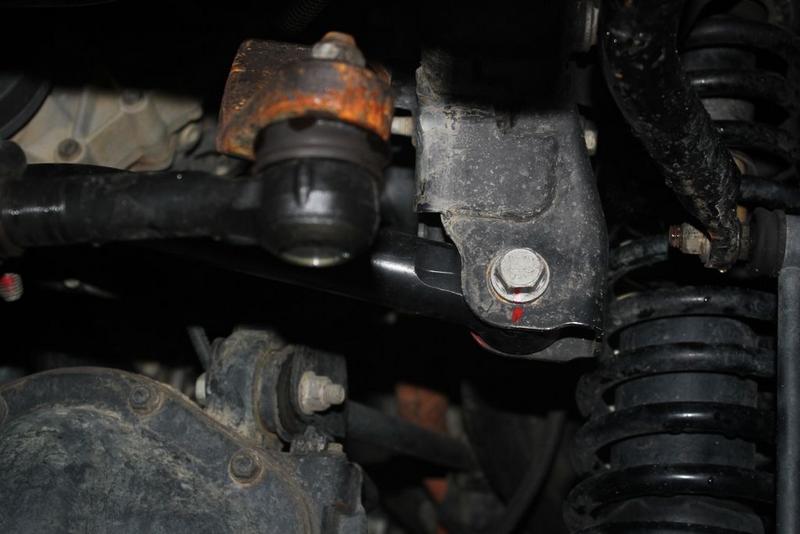

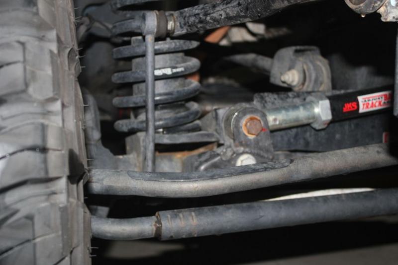

Sounds logical. And I do run a short arm lift so it would tend to lift and settle during ac(de)celeration. But I think they are parallel. Here are a few pics. But I guess maybe you mean when looking at them from the front they should be at same height i.e. same plane At the frame side they start on the same plane but on the axle side the draglink does attach at a lower plane than the track bar.

Also, I did some research on what you were saying. And it doesn't have as much to do with how the bars look parallel but rather whether the center of the joints are parallel when measuring them both. Also, it seems important that the length of the track bar and the drag link are as close to matching as possible so that both of the move in the same arc when the suspension is cycling.
And fwiw, I do also have bumpsteer. So it's obvious that they are not exactly parallel and don't move on same axis when suspension cycles.
