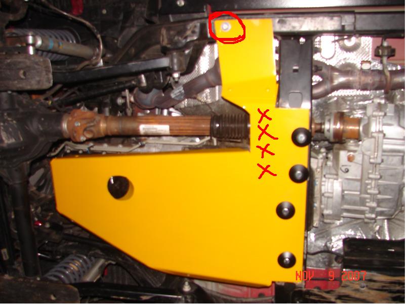

I put a few washers between the frame and the extension on the left-hand side protecting the coverter. No more rattle. No wrap.
I love the peace of mind and the "true" protection you get with rock hard
I put washers where the circle is.
I had vibrations on the X.

Hey jHarkins, on this pic, can you let me know where you put the washers?
I put washers on all four of the rear ones. If I had the diff skid, it would equal the same spacing as the washers. (hopefully one of these days)
