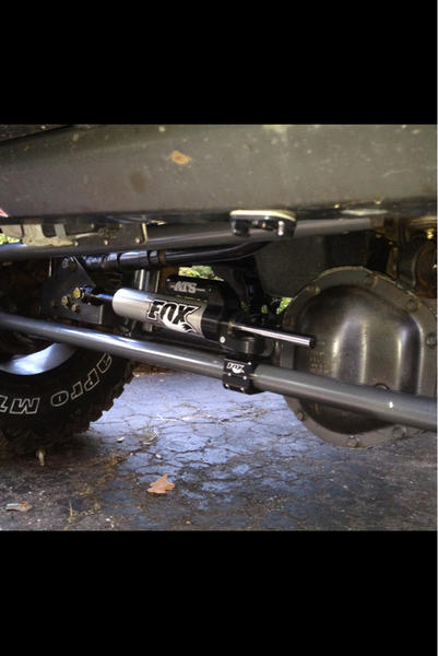

Fwiw
I'm running all synergy except the track bar which is TF.
You can see the track bar and drag link run almost parallel with each other. A high steer does a few things.
- eliminates bumpsteer
- raises front roll center (TB raised at axle end)
- less stress on the sector shaft/box (angle of DL)
- bracket adds strength
The bracket is strong and raises the axle side 3"
Also drag link is flipped over the knuckle to match the angle and 2.75 bumpstops (min 3" is required) to keep the draglink/track bar away from the frame at full stuff.
I still want to do the Synergy upper bracket and possible sector shaft brace.
