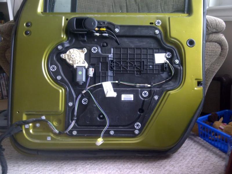

Default heres what you could expect id guess
go for it !

Nice pic! Well there you go, OP, just run along the factory wires.

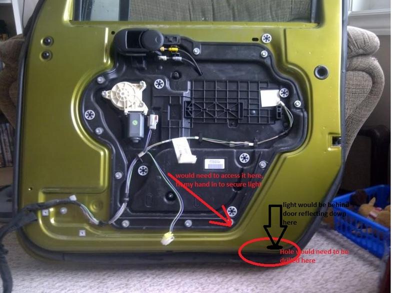

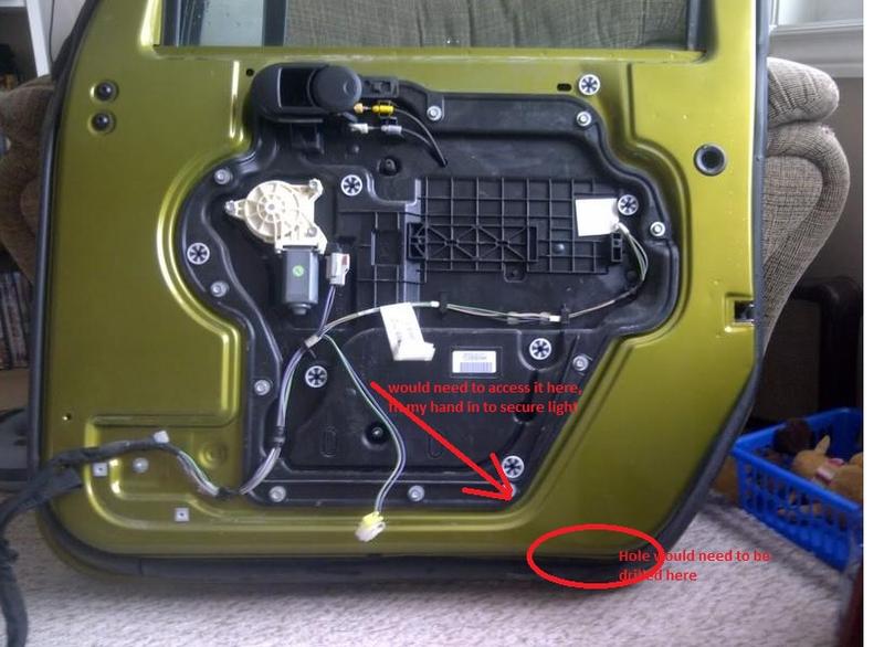

To do this right, I would need access to underneath the black plastic part. Is that easily removed as well? I could then get a quick disconnect so I could still take doors off.

I put LED's inside my door handle cups to illuminate them so passengers can find them in the dark. I just tapped into the power supply for the little LED in the lock switch. I'd just go this route so your not running additional wiring. Sure the lights will be illuminated whenever you headlights are on, but who cares if you get a faint glow from your door seal on the inside as it'll be pinned against the seat. When you open your door they will already be illuminated and work as designed. Also, I wouldn't pull the black piece, just drill a small 2nd hole to run your wire through along the top edge of the metal. Paint it and seal with silicone, you'll be GTG and it'll be much easier with less risk of screwing someting up in the window.
