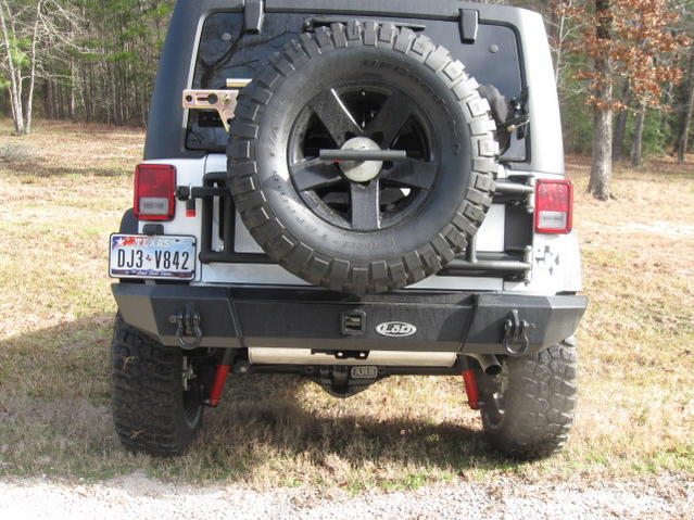

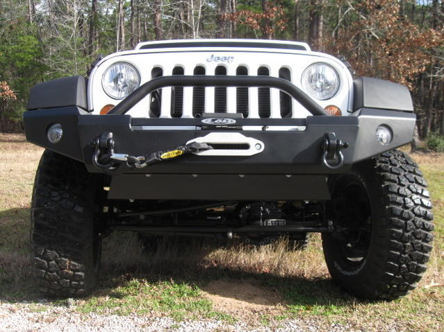

Picture of my ARB diff covers
ID:	411186Click image for larger version
