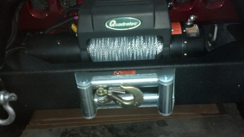

I wanted a winch, but could not justify the price of a Warn with how little I actually get off road. I went back and forth for a while between the Engo and Quadratec branded winches. After reading posts here and on other forums I decided to pull the trigger on a Quadratec Q9000s, the version with the external solenoid box and synthetic cable. Shipping was quick and I received it in less than a week from the time I ordered it.
After I installed the winch and connected it to the battery I tried to do a functions check. I plugged in the remote and rotated the drum outwards a couple of turns. Everything looked, felt, and sounded fine. Time to spool it back in a few feet. NOTHING. Not a single noise, click, tick or anything. After following the troubleshooting tips in the instructions for a drum that only spools in one direction, which consists of tapping on the solenoids, I ended up with no positive results. One call to Quadratec's customer service and they told me they would have a new solenoid in the mail to me as soon as they got them in stock. Not what I wanted to hear, but I guess that is all they could do.
But that wasn't all. Since I had a few feet of line stuck spooled out, I decided to remove the winch line completely. I was ok with this since I would have to remove the rope to feed back through the fairlead anyways once I got the winch working. Once I pulled the rope out by hand and got to the last rotation I got a another nasty surprise. The screw that connects the rope to the edge of the drum just fell off. The winch line itself was holding the screw in place. The screw was sheared and could not be used even if you tried. My guess is that it was possibly overtightened when they installed it, damaging the threads. Replacing a screw is no big deal, but I worry about the other half of the screw bouncing around inside of the winch. Who knows what other problems that could lead to. Unfortunately, by the time I discovered this, Quadratec's customer service was closed until tomorrow.

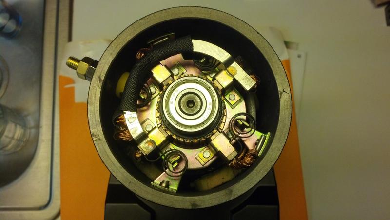

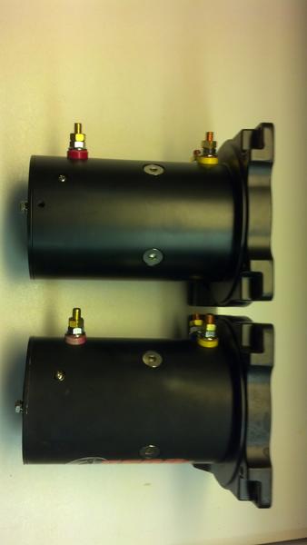

I got the Q9500i. While doing the first cable re-tensioning the line spooled in a couple of feet and stopped. The solenoid clicked and the motor terminals were getting the requisite 12.5 volts but no rotation in either direction.
I called Q-tec and they rushed me a replacement motor and a return label on their tab. Replaced motor and was working within a week of the failure. Have used the winch 3 times since with no problems.
