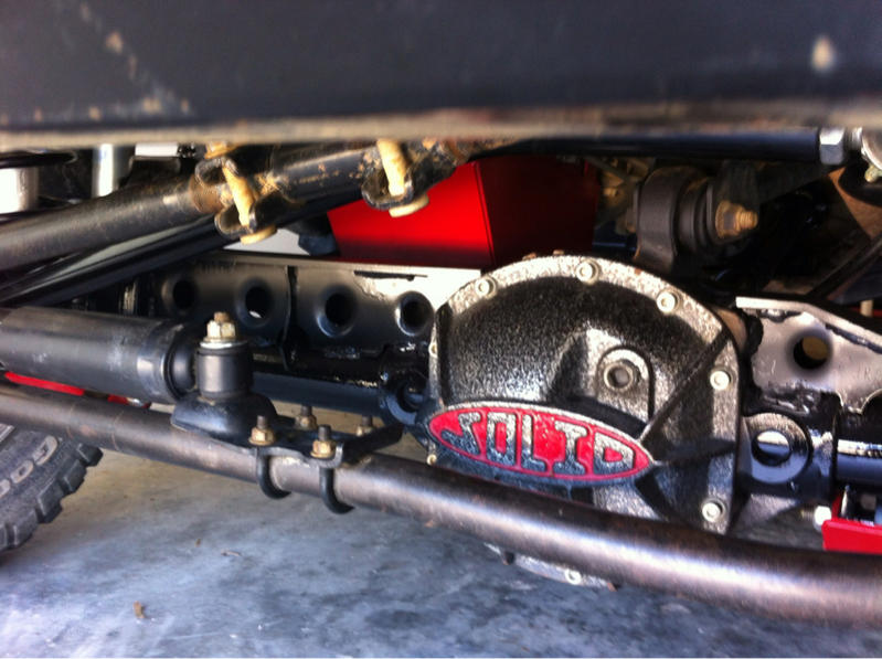

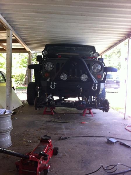

Thanks for the information guys. I am going to just truss the upper control arm bracket I am going to use and build a control arm using heims. Here is a pic of the axle now.

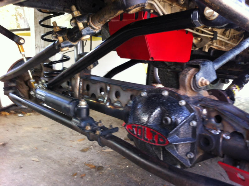

Im running a 3 link (RK) front and rear working go so far.
