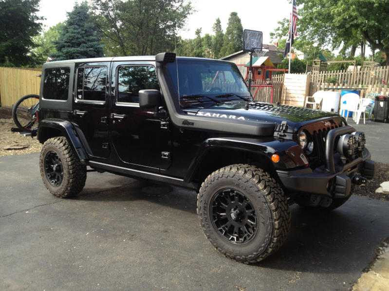

I've got the same setup as you with the TF 2.5" BB on my JKU. After I added a bumper and winch it dropped my front #19 springs an entire inch. I'd I were you, I'd put 19's in for sure. Just because the 18's are an inch taller than the 16's doesn't mean you'll gain one entire inch after installation. The weight of the bumper and winch will impact the level-ness of the front end.
You can pick some springs up in the Billboard section or just go to the dealer like I did and grab them for $45 per spring. I switched to "Rubicon" shocks at the same time and loved the result. It was a much smoother ride and didn't feel like a boat while going over speed bumps anymore.

Welcome to JK-Forum Meccano!
Attachment 557359
Attachment 557359
