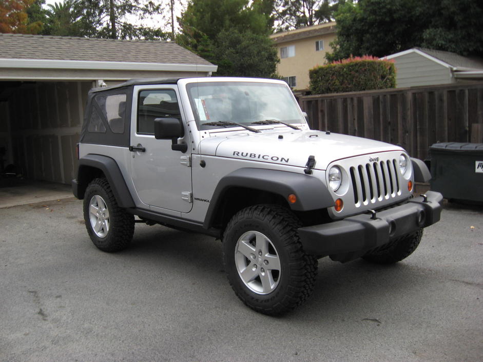

I just got these 275-70-17 MTR Goodyears,
i did my homework, and i deceided this was the best size for my application,
Its just a hair bigger than stock rubicon tires, MTR tires look much better. and my experience on these tires from the previous rubicon generation... i love these tires.
In my taste, its about proportion. This tires has right proportion in wheel, tire and lift. I dont do extreme 4 wheeling plus itl be a daily driver.
