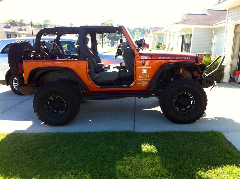

Kind of a "poser" shot, but here is my Jeep with 35" tires and Bushwacker flats as you requested.

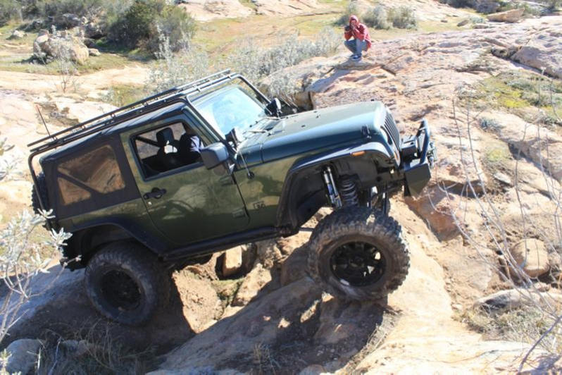

Here's a couple pics of my buddies with 35's. I've also got 35's and am going to get these fenders.
