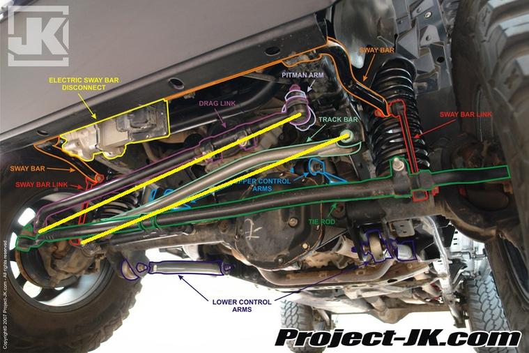

Have you verified your current trackbar/draglink angle is off, and is causing the bumpsteer? Lifting should keep them parallel, just at steeper angles. (measured from mounting point to mounting point. A frontal picture may help, rather than just eyeballing the bent bars). If they are off enough to cause significant bumpsteer, is it possible you have a drop drag link installed? (I was at 4" for several years with no flip and no bumpsteer, angle was steep, but bars were parallel.)

To be honest I'm not exactly sure what it's suppose to look like as far as the trackbar and drag link being in alignment. I will upload a front picture as soon as there is light outside.

Make sure you can see the bolts at both ends of both bars. Then open the picture in Paint or some other editing program, and draw straight lines between the holes at the axle and the holes up near the frame.
This pic is from the alignment and deathwobble writeups. The yellow lines I added may be off a bit, but they give you an idea of what I was referring to. It takes the bends out the equation so you can easily see how parallel they are.
