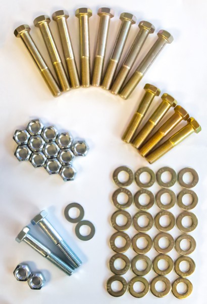

The AEV Brackets have 3 holes according to lift height 2.5",3.5" and 4.5" The only way will to find out is to try the bracket at the 2.5" position and see if that takes care of the flimsiness cause by the lack of Caster.
Also you should get a grade 8 Hardware kit
See the Video
https://www.youtube.com/watch?v=DiydwQHc7QQ
Northridge 4X4 Jeep JK Grade 8 Hardware kit
See the Video
YouTube Link: https://www.youtube.com/watch?v=DiydwQHc7QQ
<img src="https://www.jk-forum.com/forums/attachment.php?attachmentid=588836"/>
Bolt kit is a waste of $40
After reading Wayalife's writeup on the grade 8 bolts I agree.
