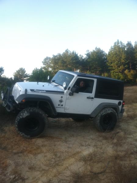

I have the TF 2.5 coil lift with Fox Shox and 15"MB72's and I'm not running anything else.
