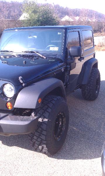

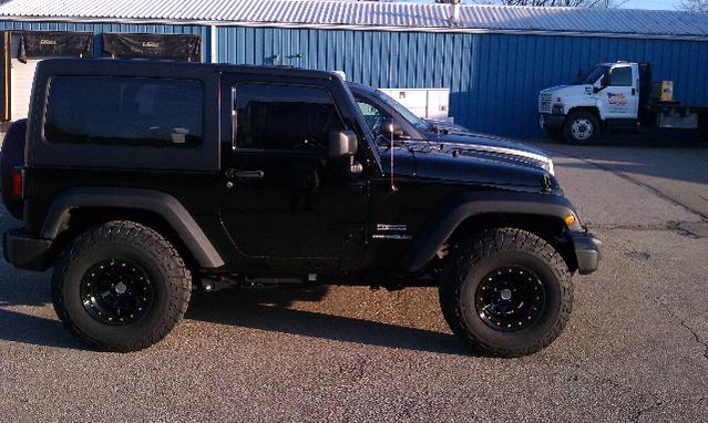

Hi, Im relatively new to the jeep community. I have a 2011 jk 2 dr. I got last may. the only mods/upgrades I've done to the jeep are front and rear quadratec floor mats, and i have 33"x12.5" general grabbers on 15"x10" procomp 152's with some serious backspacing. (magnaflow cat-back and k&n 77 CAI are on the way, will be here in a couple days).
Now with those 33"x12.5" tires and the backspacing...my tires stick out way past the fenders and i hit the fenders a lot with the tires. There's not much room to do some serious offroading and not bottom out and rip a fender off.

If you are set on just a 2" lift (coil) then you will at a bare minimum need at least:
  1. Longer shocks
  2. Or shock extensions if running stock shocks
  3. Rear extension brake line brackets
-Your steering stabilizer will work fine unless it's already leaking.
-You can either get front swaybar disconnects for convenience or just remove your front sway bar links every time you offroad and want the most flex/articulation.
-If after you install the lift and the Jeep feels flighty/Darty you can get adjustable front lower control arms to correct your caster. I ran a TF 2.5" coil lift and didn't need the adj FCAs.
-After the lift your axles may be slightly off, meaning it may be stick out more to the passenger or drivers side. An adjustable track bar can fix that, but it's more cosmetic and won't harm the jeep if you choose to leave it alone...
BTW, how is the clearance of your wheels. Love the 15x10" look/stance. Could you post some pics of the clearance of your front inner tire. I want to see how far the inner tire is from the frame & sway bar. I have been thinking about getting the same rims but plan on running 35x14.5x15 tires instead.....Thanks...
