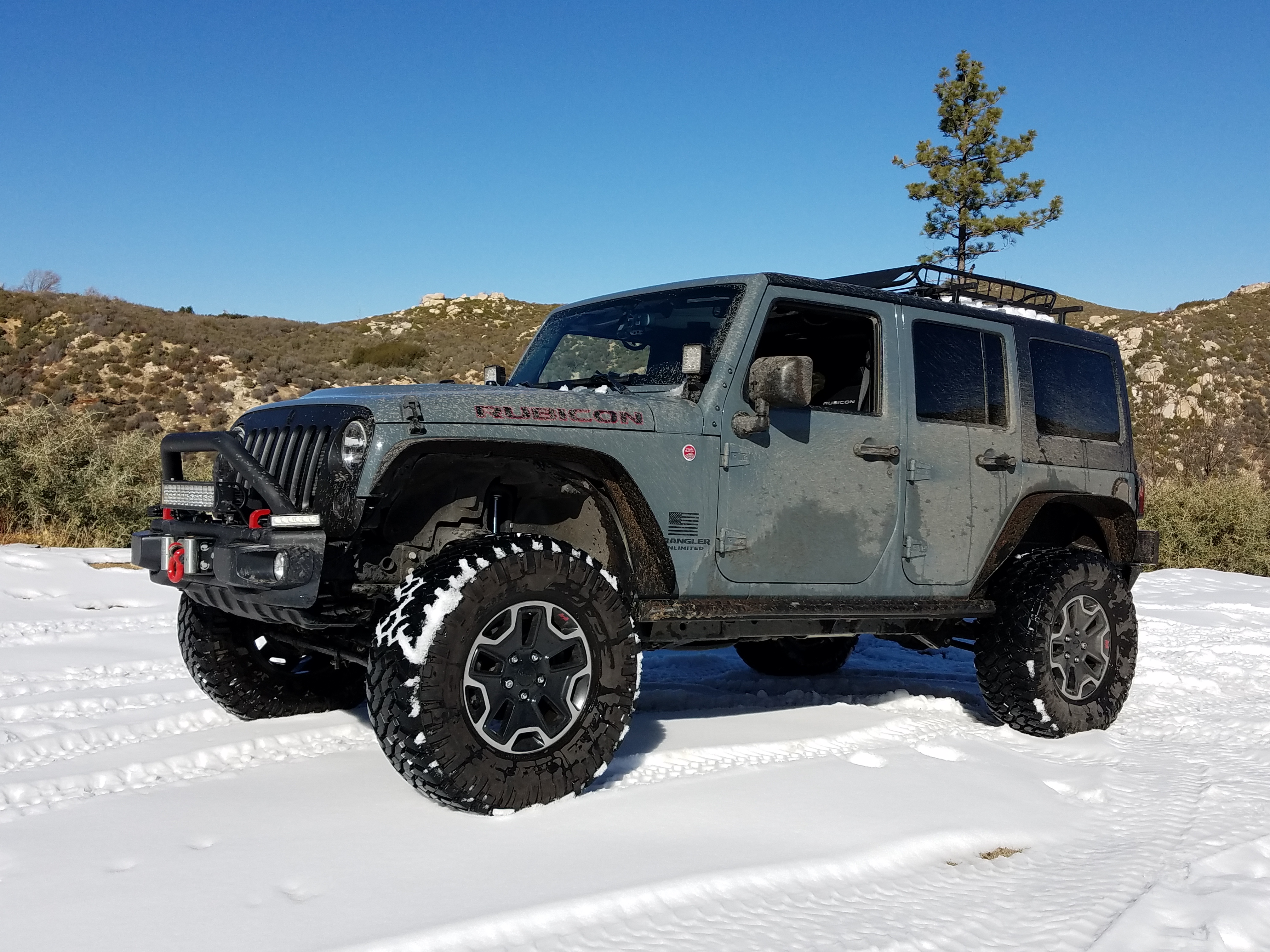

JKUR.. 3" lift, flat fenders, spacers, currently running 4.10 gears with 35's on stock D44's.
My question is, I would like to run 37's next time around when the current rubber wears out. Can I do so with the current axles, gearing or would I have to switch to D60's with something like 4.56 or 4.88's? Or should I just leave it the hell alone and keep it as is?
I drive it daily and wheel occasionally mostly overland type stuff for camping. It's always gotten me where I need to go I just figured 37's might do it that much easier.
I suppose another thing I would have to think about is possible clearance issues?
Opinions?
