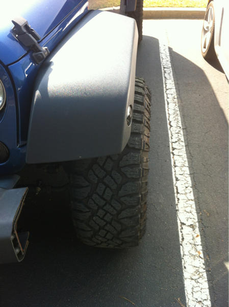

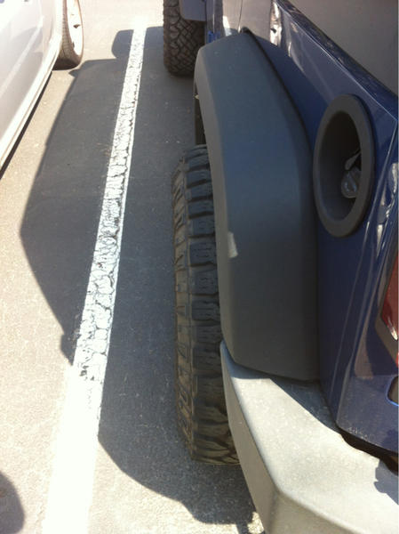

I don't know about the spacer question but when you get new wheels you'll want to get some with the back spacing to get the tires stick out like you want. I got 3.75 back spacing.
