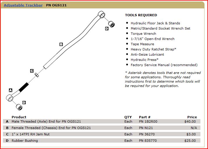

I purchase a JKS front trackbar and the instructions say the jam nut is to be tightened with a 1-7/16 open ended wrench. I took the jam nut and drove all around town looking for a wrench with no success. I ended up special ordering one from sears for $30. I got it today and it doesnt fit the jam nut (its too small).
Has this size worked for anyone else or are you all using a crescent or what.

actually, its 1-1/2". I bought a boxed wrench just for that jam nut and it was on sale for 10.00.
well good to know when I call JKS back on monday to speak to the tech. It would be nice if the can update the specs they are sending to match the products. I just bought a 15" crescent that opens to 1-3/4 so im good now
