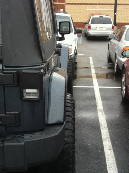

Alright I just installer my tires and wheels. They are 35s and now my steering is really sensitive. Is there any way to stiffen that up? Because on the Highway any little thing that I hit on the road steering wheel just goes which ever it wants to. Also another question is about the stiff ride I added the teraflex leveling kit and now the tires it's a really stiff ride. Getting upgraded shock will help or just air down the tires? I'm new to this and I'm not sure what psi I should be running on 315/75/16 I have it at 60 now. Please correct me if that's too high. Any help will be great thanks
