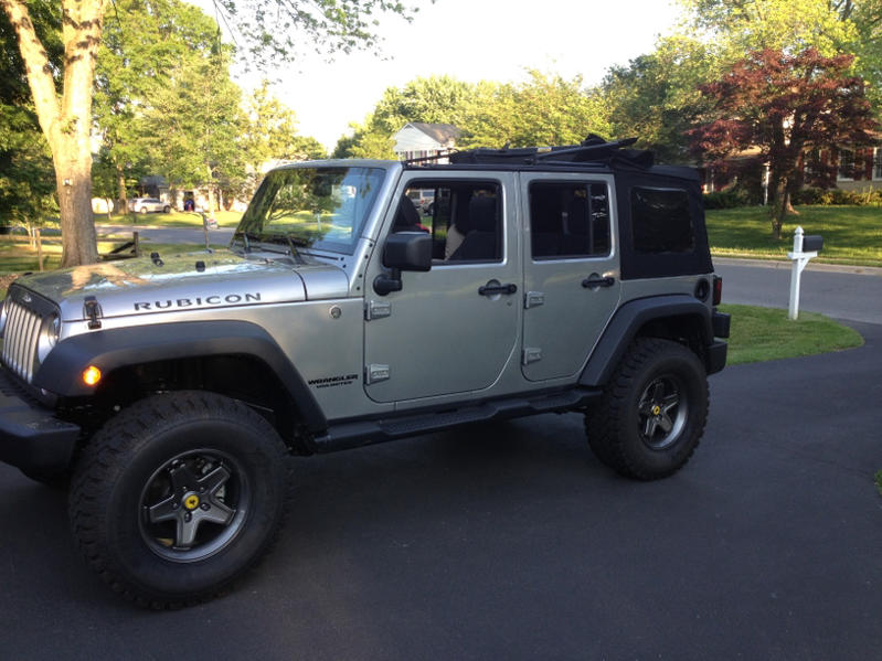

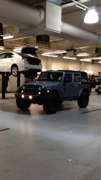

This is my 14' JKU with a 2.5" Teraflex lift with Fox shocks! I also got 35" Goodyear Duratracs on there, no complaints!

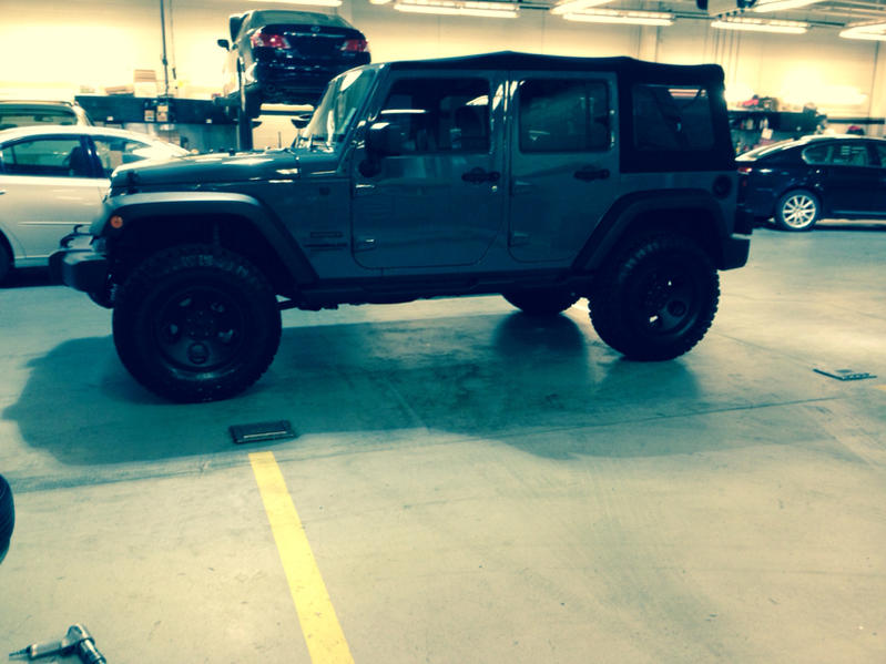

Another teraflex with pro comp extreme all terrains
