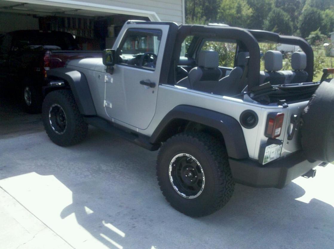

Default Here it is... new lift and tires & wheels
!.75 Daystar
16x8 7189s
BFG 285s
